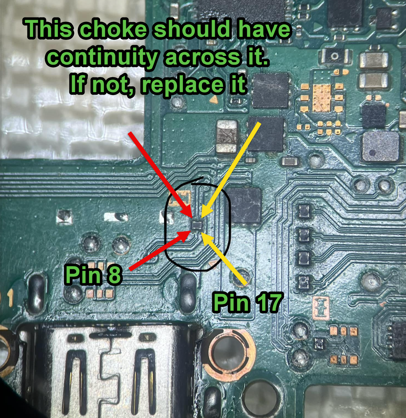

![File:Nintendo Switch OLED - Pin 8 and 17 choke.png](/images/thumb/a/a8/Nintendo_Switch_OLED_-_Pin_8_and_17_choke.png/582px-Nintendo_Switch_OLED_-_Pin_8_and_17_choke.png?20240612070746)
Size of this preview: 582 × 600 pixels. Other resolution: 1,393 × 1,436 pixels.
Original file (1,393 × 1,436 pixels, file size: 3.15 MB, MIME type: image/png)
Check this choke when your Mechanic Readings show OL for pin Pin 8 and 17
