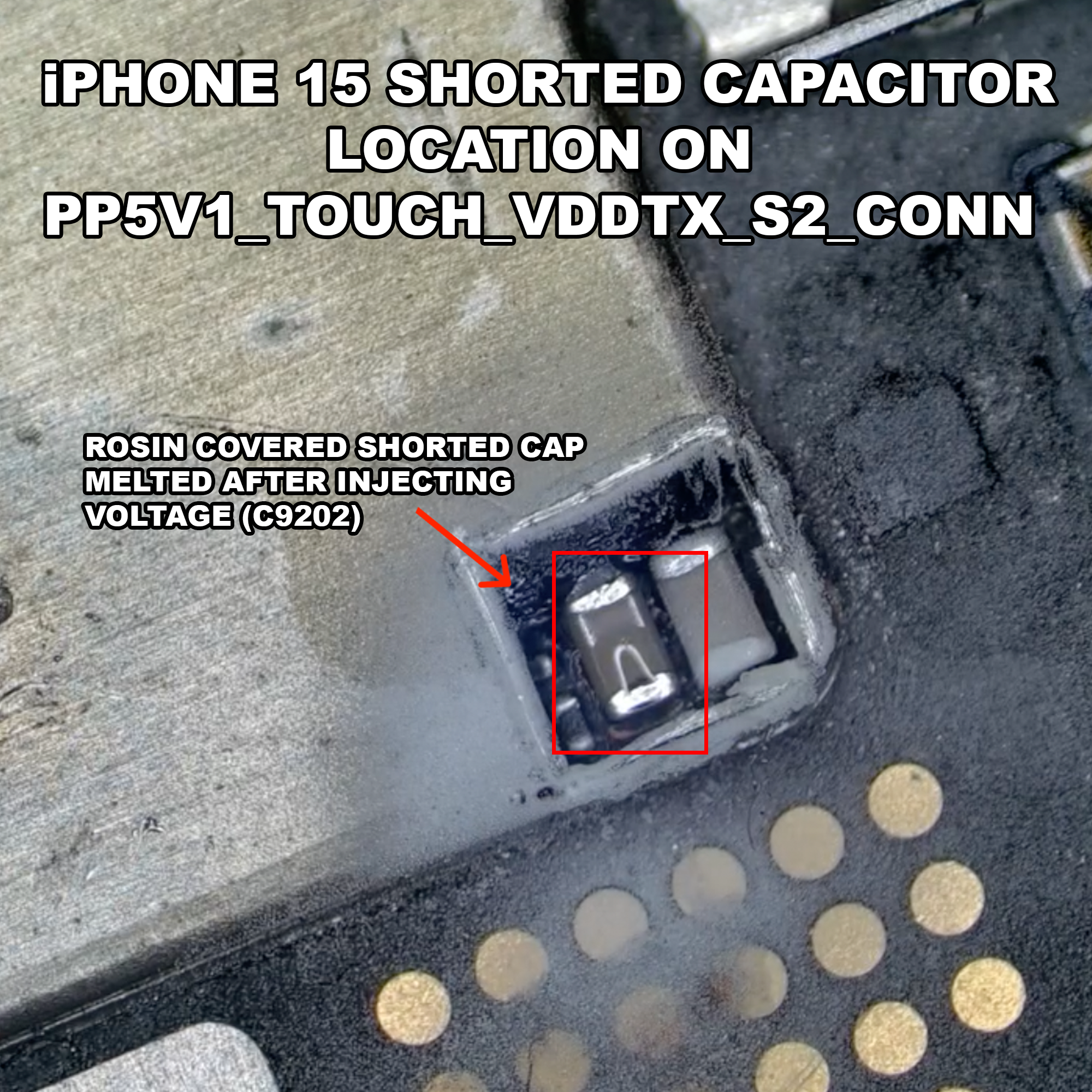

File:Iphone 15 no touch due to cap location.png
Original file(2,000 × 2,000 pixels, file size: 3.94 MB, MIME type: image/png)
