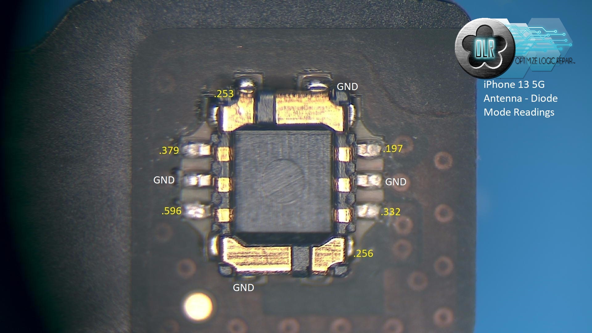

Diode readings for iPhone 13 Pro Max antenna. Connector shown is at the end of the antenna that connects to logic board.
