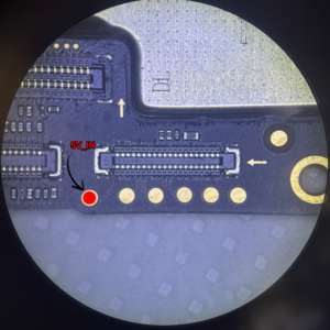

  • Check if VBUS reaches to the main board from the bottom board(as shown in the picture). If you don'e see 5 volts in this specific line then you should proceed to run a jumper from bottom board 5V VBUS and jumper to this point and check.
VBUS

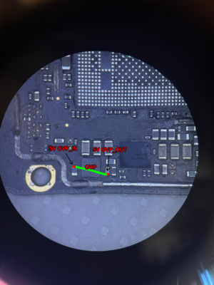

  • Check if OVP IC(over voltage protection circuit) is working properly or not:
    • Check the cap OVP_IN if 5 volt are available there, if they are not available then you probably have a missing line from VBUS to OVP_IN, run a jumper wire and the issue will be solved.
    • Check the cap OVP_OUT for 5v, if not available then you can run a jumper from OVP_IN to OVP_OUT and check. (if the OVP IC is burned it is recommended to remove it or replace it if you have one)
OVP IC

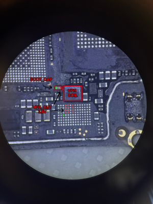

  • Check the charging ic:
    • Check if the charging ic is outputing voltage in the line called VPH_OUT (without battery)
      • if vph isn't being outputed then the problem could be the charging ic itself or it could have a minor short on the VPH_OUT
      • Check for shorts near the charging ic
CHARGING IC + BOOTCAP
  • Check bootcap: (The bootcap is a capacitor required for charging, if it shorted or missing the phone will go in fake charging condition)
    • Check for shorts on both sides of the bootcap
    • It is a cap that is not connected to Ground so to properly check if its shorted or not is to just place both the multimeter probes on the 2 poles of the capacitor to check it
    • this capacitor should output 7-9volts on the one side and 3-4 volts on the VPH side. If it outputting the same voltage on both sides then you probably have a faulty charging ic, proceed by replacing it.
