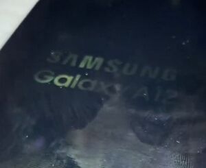

The Device turns on but screen is very dim and you need to point a flashlight to see something.
Galaxy A12 With No Backlight
Symptoms
  • The Phone Turns on but Backlight is not working

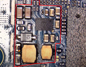

If there is no damage to the FPC we will have to diagnose the backlight circuit, this circuit on the CPU side of the motherboard.
Every component inside the red line on the image bellow is part of the Backlight circuit.
Galaxy A12 Backlight Circuit Location

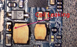

The first thing you wanna check is this coil, this coil in on the output of the circuit and it is common to leak "oil" this usually means that there is a short circuit on this line.
Galaxy A12 Backlight Coil Leaking

The most common issue is for one of these caps to blow up and short the circuit.
Galaxy A12 Backlight coil shorted
