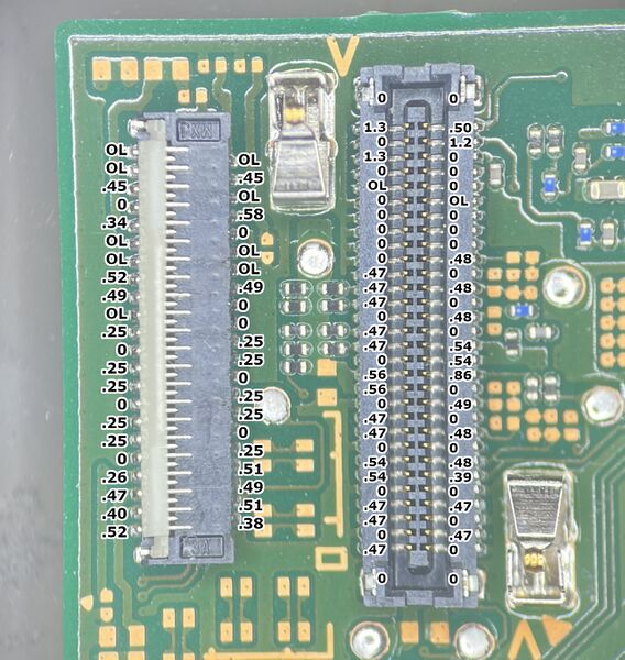

Diode mode measurements of the display connector and game cartridge reader connector on the Switch OLED
