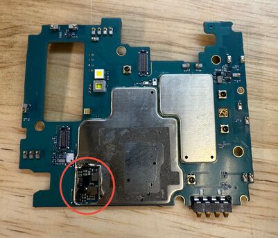

Figure 1, Samsung Galaxy XCover 6 Pro backlight circuit location

In figures 2 & 3 we can go over the backlight circuit schematic and layout of components. In figure 2, we see that the LED_A_24P is the output line that goes to the main display FPC and what supplies power to the display backlight panel so let's focus on the components that are on this line. The main components on this line will be the L9001 coil, which connects to diode D9000, then travels through several smoothing capacitors, until reaching L9032 and after one more cap outputs to the display.
  • In order to test and determine which component(s) on this line are causing our problem we will need to first get under the shield covering the components. Refer to Figure 1 for the location of components in Figure 3 on the back side of the board under where the sim tray flex normally sits.
    • The easiest way to uncover the backlight circuit will be using a grinder and shears to cut a chunk of the shield off over the top of the backlight circuit components. Make sure to not cut too deeply into the shield otherwise you might cut into and damage components that were otherwise functional.
    • If you do not have a grinder, then add low melt solder to the perimeter of the entire shield whit your iron, and then use a hot air station with high heat and airflow to lift the entire shield off of the board. This would not be the preferred method compared to using a grinder since it is a very large shield which will need a lot of heat to remove and the CPU is on the opposite side of the board to this shield which means there will be a high risk to floating the CPU
  • In my case, after removing the part of the shield covering the backlight circuit I found the L9001 coil to be burnt and have no continuity through it. If L9001 is fried then you will need to replace it. Either you will need to source the coil from another XCover 6 Pro donor board, or look for a coil on another donor board that is the same size and type.
    • If you need to source the coil from a different model try to find one used in another backlight circuit as most samsungs with an LCD have very similar components to each other.
    • You can also check the potential replacement coil's specs in ZXW or JCDrawing to make sure they line up with the XCover 6 Pro L9001 rating of 10uH
    • If you can't find another the exact coil from another samsung backlight circuit or exact specs, just look for one a coil that looks identical to L9001 and it should work
