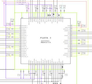

These the most common failure points on a PS5 with no image
PS5 HDMI Encoder Circuit
1.Examine the PS5’s HDMI port
  • Inspect the HDMI port for bent pins, debris, or physical damage.
  • Inspect the connection of the HDMI port to the motherboard for any ripped pads or broken solder joints.
  • Check for continuity from the inside of the HDMI port to an HDMI port breakout board.
2. Examine the PS5’s HDMI encoder circuit(MN864739)
  • Check for any damage around the MN864739 chip, like liquid damage or physical damage (cracks,holes).
  • Check for any shorts on the surrounding components.
  • Check for missing voltages the HDMI circuit in order to work needs the following voltages: 5V , 3.3V 1,8V, 0.9V

Replacing the HDMI encoder (MN864739)
Desoldering the Old Chip:
  • Set up a board preheater (if available) to warm the PS5 motherboard, as it requires significant heat.
  • Apply heat to the MN864739 chip from above using a hot air station or soldering iron. Heat for several seconds until the factory solder begins to melt.
  • Gently nudge the chip with tweezers. If it moves, it’s ready to be lifted off.
  • While the board is still hot, use solder wick and a soldering iron to clean old solder from the motherboard pads.
Preparing the Motherboard and New Chip:
  • Apply a thin layer of new solder to the cleaned motherboard pads. Avoid excess solder, especially in the center square.
  • Pre-tin the pads of the new MN864739 chip with a small amount of solder to ensure good contact.
Soldering the New Chip:
  • Align the new chip on the motherboard. Match the dot on the chip to the small triangle marker on the motherboard for correct orientation.
  • Heat the chip from above using a hot air station. Watch for the solder to melt, indicated by slight chip movement.
  • Gently touch the chip with tweezers to let surface tension settle it into place. Avoid excessive force.
Inspection and Cleanup:
  • Inspect all connections under a microscope . Ensure there are no solder bridges between pins.
  • If any connections look faulty, gently touch the affected pad with a soldering iron to reflow and correct.
