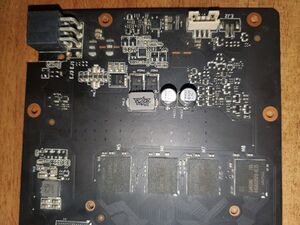

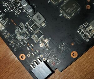

Figure 1: Broken off resistor

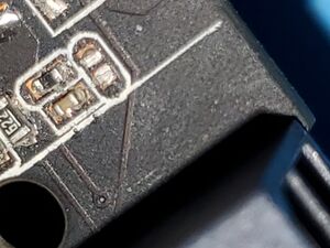

Figure 2: Broken off resistor. Zoomed in.
This solution is specific to my issue. Same error, but causes could be different. I received this error during MB+CPU+RAM upgrade and then trying to hide 2pin cable for better looks in GPU cut out next to 6pin connector. At that moment I didint knew that I had accidentally broken of resistor and made conclusion after repairs. Steps taken:
  1. Inspected power cables, tested on different system - it is indeed a GPU issue.
  2. Inspected board. Noticed missing resistor. According to boardview its R1079. See image "Figure 1". Zoomed in version "Figure 2". It is very easily missable and hard to notice that it was broken off.
  3. Getting resistor value from boardview. Its 0 ohm resistor. So just bridging contacts with solder. See "Figure 3".
    Figure 3: Bridged contacts, 6pin connector PCB side

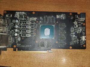

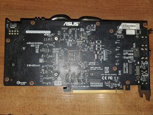

      Asus GTX 1060 6GB Bottom PCB view
Asus GTX 1060 6GB Top PCB view

Small addition to the "lack of schematics" case: the message about PCIe power connector has common mechanics in ALL nvidia GPUs for ~10 years.
So the schematics for slightly similar model can be used for reference. Such schematics will give the idea which elements are used to sense power connector presence and report to the GPU via logic low/high of "GPIO LOW_PERF" signal line. Then such elements can be found on the board by using multimeter "beep mode" with one probe fixed on a known place (starting with sense pin of a power connector) and the other scanning the board for connected elements. This way, the area of mentioned above elements can be found and precisely inspected for damage.
