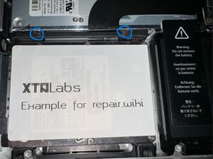

3) Remove the HDD
Using a PH000 Phillips screw driver loosen the 2 screws circled in the picture. These screws are captive and do not come all the way out. Once the screws are loose you should be able to lift the bracket out.
Once you have removed the bracket, you can carefully lift the HDD or SSD out of the laptop enough to disconnect the flex cable and then you can fully remove the HDD or SSD. A good thing to note is that if you are upgrading your MacBook Pro's SSD or HDD during this process you will need to retain the 4 T6 screws that are screwed into the side of your original drive so that you can move them over to the replacement.

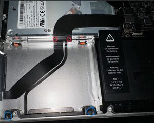

4) Remove the cable
Using a PH000 Phillips screw driver remove the bottom bracket screws (circled in blue). Keep in mind unlike the top bracket these screws are not captive and they do come all the way out.
Then remove the cable screws (circled in red), these screws are also not captive and they are tiny so make sure to store them in a place you will not lose them!
There is 2 ways to remove this cable and both work just fine.
Either push the bracket up and use the leverage you have on the bottom bracket to slowly pull the small section of flex cable up and off the bottom case (It is adhered on) and then disconnect it from the logic board and completely remove the cable from the case or disconnect the flex cable first and use it for leverage to pull the small section up and then out of the case. Either way works. You can also tip a small amount of isopropyl alcohol over the small section of the flex cable to make it remove easier however only do this in the case of a cable that is broken as it will ruin the adhesive. Also make sure the bottom case is fully dry before attempting to adhere the new cable down!
You can clean the old adhesive off with some isopropyl alcohol once removed however in most cases unless the old adhesive is dirty, you really don't need to.
5) Install the new cable!
The final part! If you are using a new cable with a bottom bracket preinstalled this part is just the reverse of removing it. Remove the adhesive protective backing and place the bottom bracket in first (The small portion of the cable should face down so it rests against the housing) screw it in and and rub your finger along the small portion of the cable to ensure it adheres to the housing. Make sure to follow the same path as it was originally installed to avoid bending and damaging the new cable then screw the cable into the housing, connect the cable to the logic board, reconnect your HDD or SSD, screw the bracket back in, reconnect the battery and replace the bottom case and screw it back in and done! Your machine should not face any more errors either booting or installing the OS! :)
