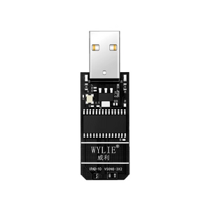

In this guide we will use a cheaper alternative to the JCID method, this device can be found for around 15€ in websites like Aliexpress.
In order to use this device we must first install the drivers for it, the drivers are available here Drivers

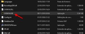

After downloading the drivers and installing them you need the software to program to Read/Write to the ROM you can find it here Software
After downloading the file unpack the RAR and run this program.
