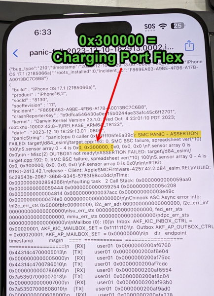

File:Charging Port Flex Panic Log.png
Revision as of 23:04, 12 December 2023 by VCCBoardRepairs (talk | contribs)
Original file(1,137 × 1,571 pixels, file size: 3.31 MB, MIME type: image/png)
iPhone 15 Pro Max panic log example. It will restart if the charging port flex is unplugged, causing 0x300000 panic log error
current23:04, 12 December 2023Thumbnail for version as of 23:04, 12 December 20231,137 × 1,571 (3.31 MB)VCCBoardRepairs (talk | contribs)
