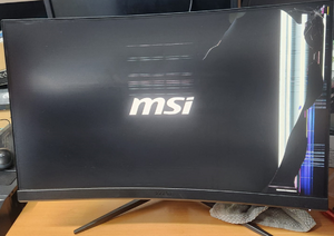

Broken LCD Panel, usually results from small falls or the classic UPS delivery man throwing your box around
image shows a broken LCD panel of the screen
Example of broken LCD panel
Symptoms
  • Broken LCD panel, resulting in discolored screen or missing pixels
Solution
order a new panel, wait for it to arrive, disassemble the monitor, replace the panel, reassemble the monitor

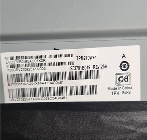

monitor uses TPM270WF1-ST2701B01925A Panel from TP Vision
