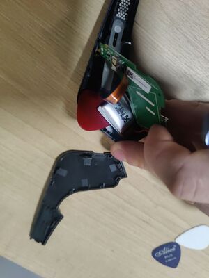

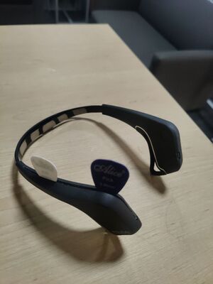

- Open the clips covering the circuitry behind the left ear. Use a pick to pry open a gap, and use a second pick to undo the plastic clips. Note that there are clips on the underside, too.

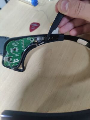

Using two guitar picks to disassemble a Muse (2016) - Use tweezers to carefully remove the ear electrode connection.
Using tweezers to remove the ear electrode connection on the Muse (2016) - There is a ribbon cable behind the board that connects to the main electrodes, and the battery is soldered to the board and glued to the back. Partially remove the board to reveal the battery. Be careful not to damage the ribbon cable. You do not need to disconnect the ribbon cable.

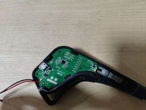

Using a guitar pick to pry the battery in the Muse (2016) loose - Taking care to make sure not to puncture or otherwise damage the battery, use a guitar pick to pry the battery loose. It can take quite a lot of force to remove the adhesive, so you don't need to be gentle, just be careful.

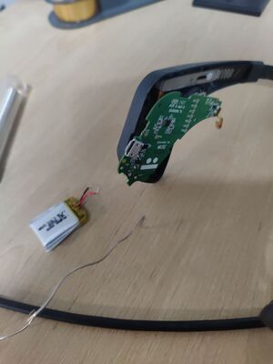

- With the battery loose, desolder the battery connections, ideally with a chisel or other large tip. The ground plane is large and requires a lot of heating with a normal tip.
Muse (2016) with desoldered battery - Insert the replacement battery into the area the previous battery was, and lay the wires in the indent in the enclosure. You may have to cut into the battery's kapton tape so that the wires can exit in the right place.
