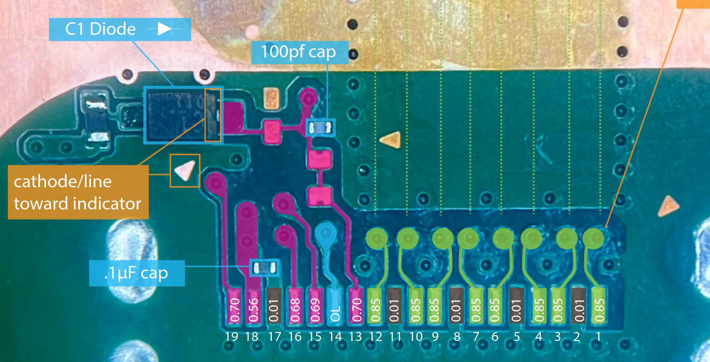

layout of the hdmi port and the traces. color coded to follow the pairs and patterns explanation
