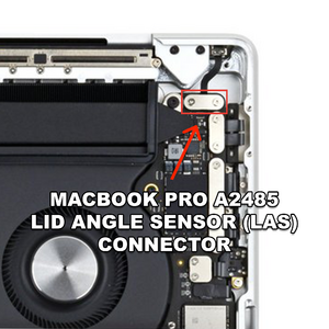

MacBook Pro A2485 powers on but keyboard and trackpad are unresponsive, and the display keeps turning off and on every few seconds. The system remains powered but only functions while connected to the charger. No visible liquid or corrosion damage.
MacBook Pro A2485 Lid Angle Sensor
Symptoms
  • Keyboard and trackpad not working.
  • External keyboard/trackpad via USB work normally.
  • Screen blacks out every 2 seconds, though the device remains powered.
  • MacBook powers only when plugged into the charger — doesn’t boot from battery alone.
  • No visible liquid or burnt components.
  • Replacing the trackpad or battery does not resolve the issue.
Solution

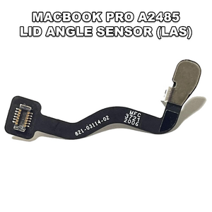

Replace the angle sensor flex cable (also known as the lid angle sensor flex).
MacBook Pro A2485 Lid Angle Sensor Connector Location
This flex cable communicates lid angle position; when shorted or faulty, it causes erratic power management signals, preventing keyboard/trackpad initialization and causing display blackouts.

  3. Angle Sensor Isolation Test
    • Disconnect the angle sensor flex from the logic board.
    • Reconnect battery and charger.
    • If device now powers on normally and display stays stable → confirmed faulty angle sensor flex.

  2. Open the back cover and locate the angle sensor flex (near the hinge area, connecting the display hinge to the logic board).
  3. Disconnect the flex and visually inspect for damage.
  4. Replace with a known-good or new OEM angle sensor flex.
