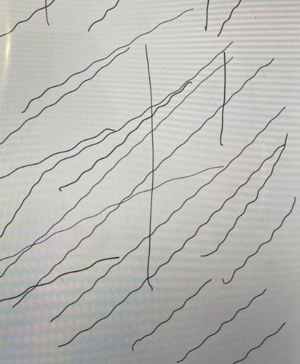

Problem description
After replacing the screen the Apple pencil can not be used to draw diagonal lines.
Example of issue
Solution
