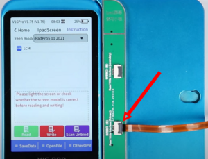

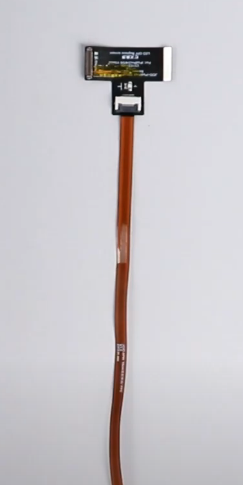

First Connect the flex cable to the right adapter for your model
Then Connect the adapter board to the iPad like this
Flex Adapter
Now Connect the ORIGINAL screen the iPad had installed, and power on the device.
Next on the Programmer use the buttons to select the Model of your device
Then connect the Flex to the programmer like this
JCID Flex Connected
Now press the power button to light the screen up and press the read button on the JCID Programmer
After reading the old information from the screen you can turn off the iPad and plug your new screen in.
With the new screen in connected press the power button to light up the screen and click on Write in the JCID Programmer
