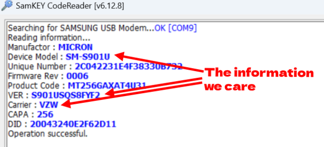

Step 2: Identify Your Device's Details
  1. Boot your device into Download Mode, If you dont know how simply google: How to place [Insert your device here] into download mode
  2. Connect the device to your PC via USB.
  3. Open SamKey and click "Read Info D/L." Note the:
    • Device Model (e.g., SM-G990B2).
    • Version (firmware build).
    • Carrier/CSC
If the device won't enter Download Mode, ODIN can't help—suspect hardware issues like CPU or eMMC failure.

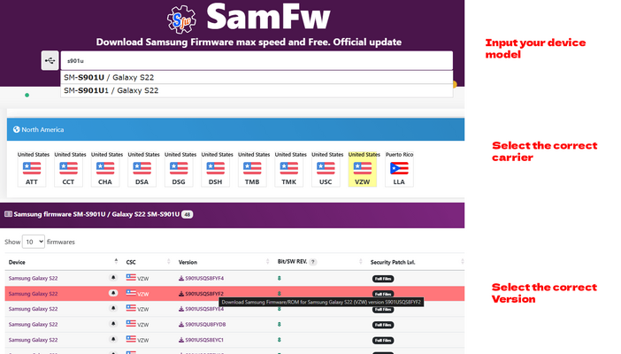

Step 3: Download Firmware
  1. Go to samfw.com
  2. Enter your device model, select your CSC/region, and match the version from Step 2.
