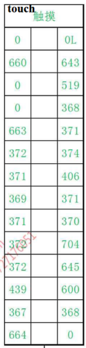

iPhone XS Max Touch FPC Diode Values

Take diode readings of the Touch FPC and compare them with the image on the side.

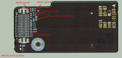

If everything is ok the next step is to check if the main touch voltages are present.
These voltages can be measured here, keep in mind that these voltages may only show up with the device powered on and a display connected.
PN6V7_RACER
PN3V5_RACER
PN10V0_RACER
PN1V8_TOUCH_RACER_S2
PN1V1_RACER
PN5V25_TOUCH_VDDH
If these voltages are present/or missing the next thing to do is split the boards, the most common issue is to have a crack on a solder joint between the interposer and the top board or a ripped pad.

When taking diode readings of the FPC, if you measure a line that should read, for example, 0.500V but get 0.100V or 0.000V, it indicates a short on that line. The best way to trace the short is to inject voltage into the line with a DCPS and use a thermal camera to identify which component heats up.
If you measure a line that should read 0.500V but get OL (Open Line), it indicates a disconnection in the circuit. To trace the issue, consult the board view to follow the line’s path.
