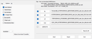

ODIN's interface includes slots for firmware files (BL, AP, CP, CSC), a Log window, Options tab, and PIT tab.

Step 4: Load Files into ODIN
  1. In ODIN:
    • BL: Insert the Bootloader file (BL_ prefix). Loads system files and Android.
    • AP: Insert the Android Processor file (AP_ prefix). Flashes to /system partition (largest file, takes longest).
    • CP: Insert the Core Processor file (CP_ prefix). For modem/radio images.

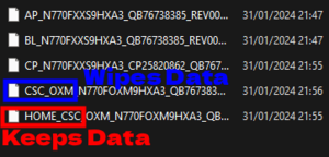

    • CSC: Insert the CSC file for region/carrier changes. !!!VERY IMPORTANT!!! Use HOME_CSC_ to keep data (no wipe); regular CSC_ wipes data for a clean install.
  2. ODIN should detect your device (COM port lights up blue).
ODIN Should look like this when all the files are imported
