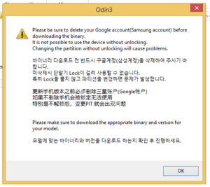

Now lets open ODIN depeding of the version you download you may get a pop-up window like this just click ok.
After this your device should be ready like this:
