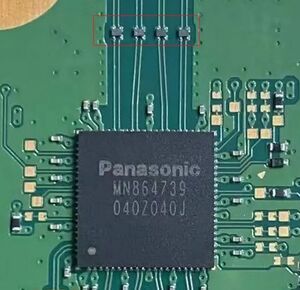

2. Examine the chokes between the HDMI encoder and the HDMI port.
  • There are 4 chokes between the encoder and the HDMI port (L3001,L3002,L3003,L3004)
  • There are 8 data lines going through these chokes (each choke carries 2 data signals), make sure every one has continuity.
3. Examine the PS5’s HDMI encoder circuit(MN864739)
  • Check for any damage around the MN864739 chip, like liquid damage or physical damage (cracks,holes).
  • Check for any shorts on the surrounding components.
  • Check for missing voltages the HDMI circuit in order to work needs the following voltages: 5V , 3.3V 1,8V, 0.9V you can check the image below a good working console should have all those voltages.

Replacing the HDMI Chokes
Use a hot air rework station to heat the solder joints of the old choke. Apply heat evenly until the solder melts, then gently remove the choke with tweezers.
After removing the choke, clean the pads of old solder using a soldering iron and solder wick.
Apply a small amount of solder to the cleaned motherboard pads.
Align the new choke and apply heat (use a low air speed to avoid dislodging the choke). When the solder beneath the choke melts, surface tension will pull the component into place.
Replacing the HDMI encoder (MN864739)
Desoldering the Old Chip:
  • Set up a board preheater (if available) to warm the PS5 motherboard, as it requires significant heat.
  • Apply heat to the MN864739 chip from above using a hot air station or soldering iron. Heat for several seconds until the factory solder begins to melt.
  • Gently nudge the chip with tweezers. If it moves, it’s ready to be lifted off.
  • While the board is still hot, use solder wick and a soldering iron to clean old solder from the motherboard pads.
Preparing the Motherboard and New Chip:
  • Apply a thin layer of new solder to the cleaned motherboard pads. Avoid excess solder, especially in the center square.
  • Pre-tin the pads of the new MN864739 chip with a small amount of solder to ensure good contact.
Soldering the New Chip:
  • Align the new chip on the motherboard. Match the dot on the chip to the small triangle marker on the motherboard for correct orientation.
  • Heat the chip from above using a hot air station. Watch for the solder to melt, indicated by slight chip movement.
  • Gently touch the chip with tweezers to let surface tension settle it into place. Avoid excessive force.
Inspection and Cleanup:
  • Inspect all connections under a microscope . Ensure there are no solder bridges between pins.
  • If any connections look faulty, gently touch the affected pad with a soldering iron to reflow and correct.
