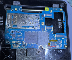

[[File:2025 05 13 15 19 IMG 77781-Recovered.png|thumb|175x175px|check diode values on these pads]]
=== Diagnostic Steps ===

* Mainly this issue occures after a heavy drop
* Check if these diode values on fpc are ok.
* Check diode readings on the following lines, if you have OL or high diode values at these pins then you should follow this guide. <br />

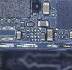

[[File:2025 05 13 11 44 IMG 7766.png|thumb|149x149px|find the  problem]]
# Start by removing or grinding the front baseband section and CPU shields.
# After you have carefully removed the shields try to trace the area where the problem has occured. (as shown in the picture)
'''Start the repair process'''

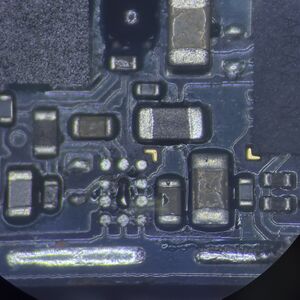

[[File:2025 05 13 12 27 IMG 7768.png|thumb|163x163px|prep the damaged area]]
# Start by removing the first layer of the motherboard(that is ground) on the area where your issue is located, it would be near the marked area. (to remove the 1st layer you can use a surgical blade #11 and be patient)
# After you have successfully removed the 1st layer you can try to find the second layer and in that layer you will find the problem that is caused by a hard drop. (you will finds something like this picture)

[[File:2025 05 13 14 14 IMG 7769.png|thumb|165x165px|fixed damaged area]]
* I personally use a little bit of no halogen flux for this repair and use 183 C paste
[[File:Ic's to check.png|center|thumb|ic's to check]]
* prep the pads that are broken white tin and start jumpering the broken traces, I preffer to use 0.007mm silver jumper wire for these kind of works.
[[File:IC and Diode value.png|center|thumb|IC's and Diode value]]
* After you have made the traces with jumper wire try to turn on the device and see if touch works properly and you have a display.
* If everything seems fine then now you are ready to apply a UV Solder Mask to finish the repair. (the end result should look like the picture.)

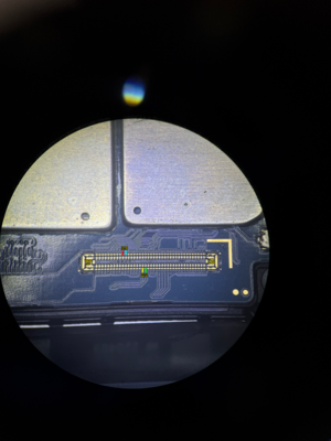

[[File:Touch and display pads.png|thumb|219x219px|pads info on the back]]
* here is some more information about these pads from where the actually go and where the lead.
[[File:2025 05 13 15 19 IMG 7778.png|thumb|212x212px|pads info on the fpc]]
