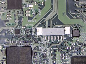

- Take out the motherboard. We will be working with the area shown in Figure 3.

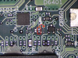

- Move the TRST resistor from pull-down to pull-up position. See Figure 4 for exact placement.
- Solder wires to the JTAG pins. See Figure 5 for the pinout. Note that with Glasgow Interface Explorer you don't need to worry about the exact pinout of the signals, because the tool can auto-detect it for you, just make sure you get the GND pin right, and that you solder a wire to all other pins except for pin 6.

- Restore the TRST resistor to its pull-down configuration, and remove the jtag wires (You may be able to test if password removal was successful without repeatedly moving the resistor back and forth, Temporarly leaving the resistor in the pull-up state has worked for the author, but it may not always work. It is definitely recommended to restore the resistor at the very end.)
