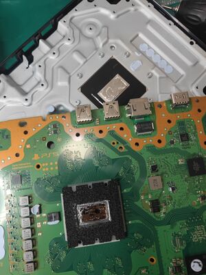

Problem description
The console overheats and shuts down why playing
PS5 too Hot
Symptoms
  • The Console shuts down while playing a game
  • The FAN is always at max speed
  • The console Shows the message "Your ps5 is too hot"
Solution
Most times this issue is caused by oxidation of liquid metal on the APU or dust that over time build up and is blocking the flow of air.

After removing the motherboard from the heatsink inspect the APU die and the heatsink it is common to have a dry spot due to oxidation.
⚠️Attention: liquid metal is conductive, so avoid spilling it on the motherboard.
⚠️Attention: Do not remove the black foam barrier around the APU.
Example of a dry spot on the APU
PS5 Dry Spot
The best way to clean this is with a cotton swab socked in Isopropyl Alcohol, like in the picture bellow.
Move the liquid metal to a side and so your best to clean the oxidation it may take multiple cotton swabs, do this for the APU side and heasink side,
Usualy you dont really have to add more liquid metal unless it got removed during the process, if you do remove a lot of liquid metal you can by some Thermal Grizzly Conductonaut and apply it.
Here is how the aplication of the liquid metal should look like.
