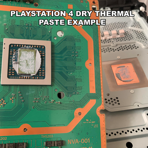

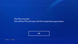

PS4 (all variants – Fat / Slim / Pro) overheats, becomes extremely loud, or shuts down with the message:<blockquote>“The PS4 is too hot. Turn off the PS4 and wait until the temperature goes down.”</blockquote>Most common causes:

[[File:Ps4-overheat-warning.jpg|thumb|PS4 Overheating Warning]]

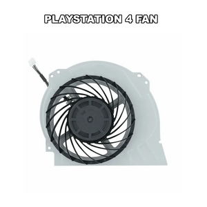

[[File:PS4 FAN.png|thumb|Playstation 4 Cooling FAN]]

* Overheating warning

[[File:PSE4 DRY THERMAL.png|thumb|Playstation 4 Dry Thermal Paste]]

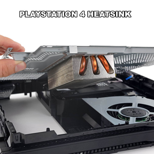

[[File:PS4 HEATSINK.png|thumb|Playstation 4 Heatsink]]

==== 2. Boot Test ====
* Power on the PS4 while watching the fan:
** Spins at boot = Fan OK
** Clicks or hesitates/No spin = Worn bearings or mechanical fan fault
==== 3. Thermal Paste Check ====
If PS4 has never been serviced:
* Thermal paste is usually dry
* Dust likely packed inside heatsink fins

==== 4. Heatsink Airflow Check ====
Common issue: packed dust wall between fan and heatsink.

===== Fan Cleaning =====
* Use compressed air + soft brush
* Spin fan manually to verify smooth rotation
* If grinding noise → Replace fan

==== 3. Thermal Paste Replacement ====
* Remove old paste from APU and heatsink using isopropyl alcohol
* Apply high-quality thermal paste (Arctic MX-4 / Arctic Silver / Noctua NT-H1)
* Ensure full flat contact with even pressure

=== 5. Replace Fan (If Dead) ===
==== When to replace: ====
* No spin at boot
* Weak or intermittent spin
* Noise from bearings
* Burnt smell or discoloration
==== Part requirements: ====
* Model-specific fan (PS4 Fat, Slim, Pro each use different connectors)
Replace fan → test again.
  • Thermal paste is usually dry
  • Dust likely packed inside heatsink fins

Heatsink Cleaning
  • Remove old dust “blanket” from heatsink fins
  • Flush with air from both directions
  • Remove old paste from APU and heatsink using isopropyl alcohol
  • Apply high-quality thermal paste (Arctic MX-4 / Arctic Silver / Noctua NT-H1)
  • Ensure full flat contact with even pressure
When to replace:
  • No spin at boot
  • Weak or intermittent spin
  • Noise from bearings
  • Burnt smell or discoloration
Part requirements:
  • Model-specific fan (PS4 Fat, Slim, Pro each use different connectors)
