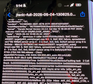

15 Pro 0xa1 Panic Log Example
Figure 1 - iPhone 15 Pro 0xa1 Panic Log Example

  • Panic Log Error code is 0xa1 (Figure 1)
