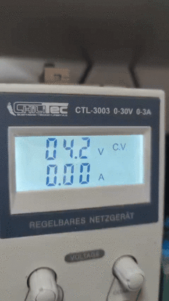

To detect the short you'll need to inject voltage (4 V / 2 A) directly into the line you measured as short and use freeze spray (see here https://youtu.be/3MtLSQJvQxI) or thermal camera (see here: https://youtu.be/fkd4iDjgfvc) to spot the capacitor that is shorted.

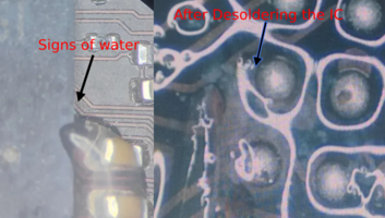

iPad Pro 9.7 Example
If the Short is on a Chip you need to replace that component.
If the Short is on decoupling capacitor you can remove it from the board most of the times the capacitance wont drop that much to affect the function of the device.
If there is water damage, corrosion may be the cause of the short sometimes cleaning the corrosion is enough to clear the short however if you see signs of water by a chip it probably means there is water under the IC and you have remove it clean the corrosion aand reball or replace the Chip.
Water by a chip
