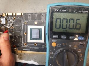

- With your multimeter, measure the resistances of the voltage rails, refer to this or this page for reference measurements
- You should measure a short circuit on 1.8V rail (Figure 1), if not, this guide is not applicable to your problem

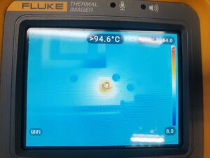

- Inject 1V to the rail and see what heats up using a thermal camera or other short finding methods.

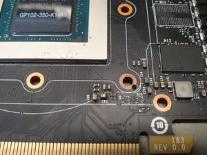

- In this case, it was a capacitor under the core (Figure 2, 3)
- You might have a different capacitor that is shorted or the core itself, if you feel the core itself is getting warm, it's a dead core.
Repair Steps
Simply de-solder the old capacitor and measure if the short is gone, if it is gone then replace it with another (22uF 6.3V 0603). Stress test the card after and reassemble.
